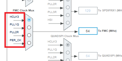

Meanwhile, FMC kernel clock can be derived from the following clock sources:

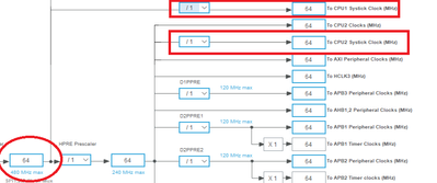

While the system tick clock is derived from the system clock source:
