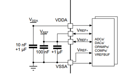

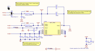

So are cer.caps on VDDA and VREF+ - or not? (from G473 ds )
or from nucleo-G474 :
If not : try with soldering a thin wire from VREF+ to a cer.cap 1uF to gnd. Then test again.
