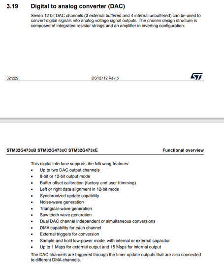

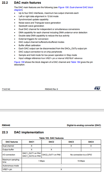

KDJEM.1
Hello @licunxu and welcome to the community;
According to the reference manual and the datasheet, the STM32G4 supports up to 4 DAC interfaces and maximum two DAC output channels each.
Thank you.
Kaouthar
