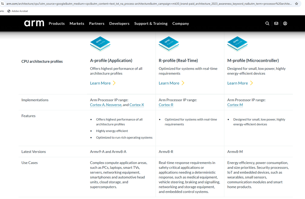

2025-01-04 1:48 AM - edited 2025-01-04 2:15 AM
@tjaekel wrote:
- some boards (larger and more complex MCUs) can also run a full Linux (e.g. Raspberry Pi, PYNQ (FPGA) board)
They would not (generally) be called MCUs but, rather, MPUs - or "Application processors"
Cortex-M = Microcontrollers;
Cortex-A = Application processors:
@tjaekel wrote:
- even Raspberry Pi: there is full-blown Linux with RPi 5, smaller as RPi Zero and very small as RPi Pico
RPi Pico is a microcontroller (Cortex-M0+) - the other RPis are Cortex-A
https://www.raspberrypi.com/products/raspberry-pi-pico/
