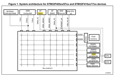

2025-05-21 7:57 AM
> Surely this should work with DMA1 as well?
There is no link between DMA1 and AHB1, where GPIOD is located. Use DMA2.

Yes, I was looking at that post earlier and comparing with my own code and from what I can tell it's pretty much identical except different DMA and Timer. Surely this should work with DMA1 as well?
2025-05-21 8:04 AM
Use DMA2 not DMA1. This is what I've indicated in my post.
2025-05-22 12:24 AM - edited 2025-05-22 12:28 AM
I see now. I was trying to find something like that bus matrix table before but didn't know where to look. That makes sense then why it wouldn't work. Now I need to modify our hardware since it's locked into TIM2 which can't be used with DMA2.
