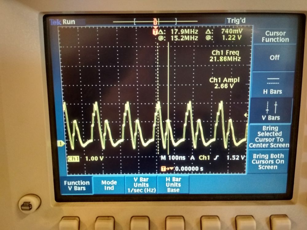

Looks very much like you're hitting the limits of your measurement setup, i.e. scope bandwidth and (more probably) probe bandwidth - unless there's some limitation imposed by the PCB and/or connected circuitry, too.
Is it a 1:10 probe?
Also, from which memory are you running? Did you confirm your system clock runs at the frequency you assume it does?

2017-11-07 3:15 AM
Just to double check, something like this:
while (1)
{ /* USER CODE END WHILE *//* USER CODE BEGIN 3 */
GPIOC->BSRR = (1<<9);GPIOC->BSRR = (1<<25);}
I just want to check how fast I can actually do this in the main.
SYSCFG->CMPCR = 0x1;
Cause something seems odd to me, I've tried using an external interrupt, but the fastest I could get it to react to a signal was 800 kHz, so just checking the code execution with the amount of assembler lines.
2017-11-07 4:03 AM
That's about 200 cycles, not surprising at all.
The inherent entry/exit is two dozen cycles, pending stack is in single-cycle-access memory. Add to that prologue and epilogue added by compiler plus whatever processing happens in the ISR. Can get down to say 3-4 dozens of cycles if you can run it from single-cycle-execution memory like the TCM RAM.
2017-11-07 4:21 AM
JW thank you for the confirmation and help.
By just doing the above code, with the BSRR, I can do 22Mhz from the main while loop. I just want confirmation that this should indeed be the maximum that I can hit running from the main while? My supervisors have informed me that I should get 50 MHz minimum by doing this due to the fast clock speed. I just want to be 100% sure before returning to them.

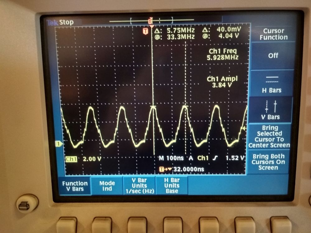

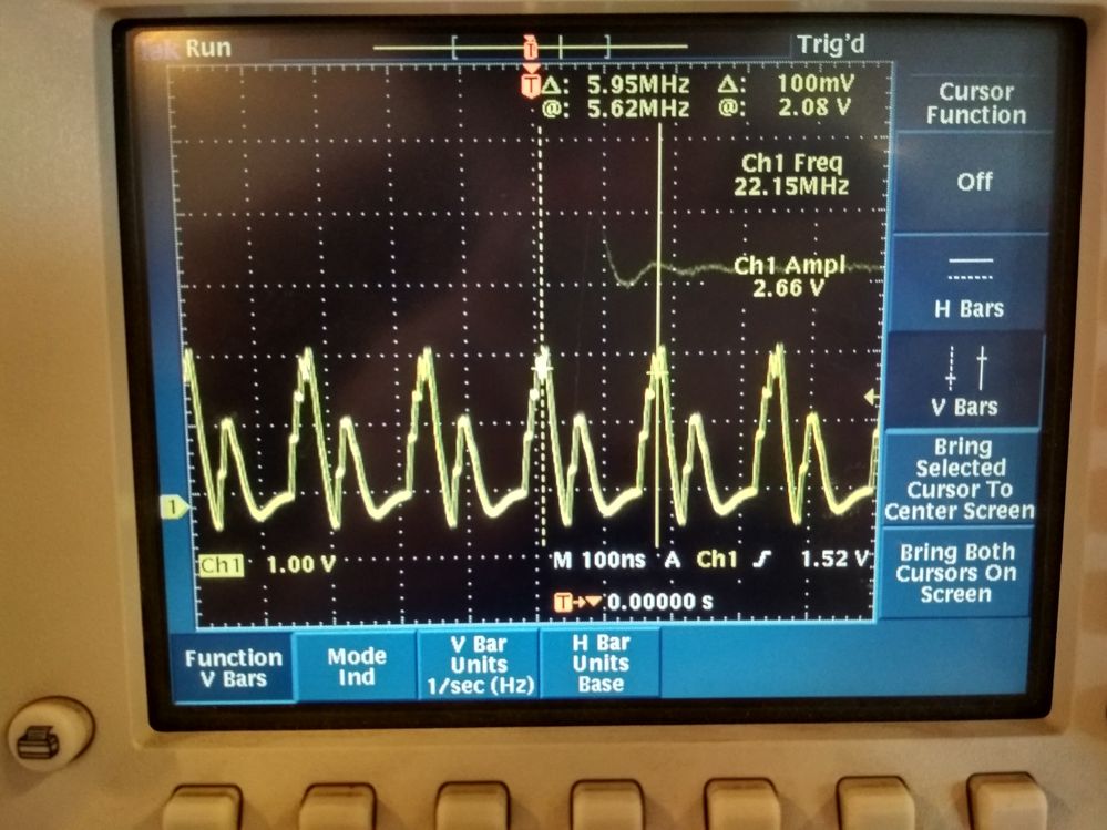

Both I and Clive told you to unroll, i.e. repeat the set/reset lines 'manually'. The jump at the end of the loop may be costly.
Look at the resulting waveform by a LA or oscilloscope (no excuses accepted).
2017-11-07 5:16 AM
Hi JW,
My apologies, I did do this, but forgot to show it in the code. Here's what I get with the compensation cell active:
Here's what I get without the compensation cell:
Without the compensation cell. it definitely looks like its struggling, although the comp cell slows it down to ~6 MHz.

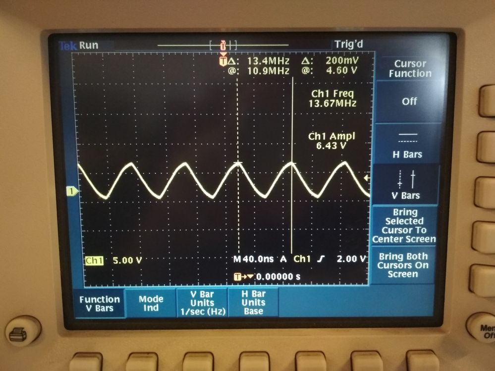

2017-11-07 5:32 AM
Using just the
while (1)
{GPIOC->ODR ^= GPIO_PIN_9;
I get the following:
