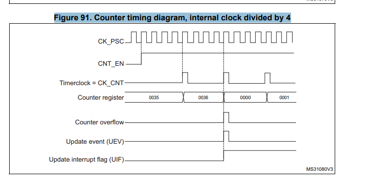

When I look into the reference manual, at page 521 of RM0090, "Figure 91. Counter timing diagram, internal clock divided by 4" shows that;
I understand from this figure that timer should count up by 1 for every 4 clock signal that it receives.
And I just kindly ask that which point I am missing?

Hey, thanks for the answer. It is same "CKD" in f4xx also. So, what does that figure represents than? They draw it like the internal clock division value just scales down the counter frequency. Am I wrong? It look just plain simple from that figure.
2019-07-10 12:07 PM
The CKD bits control the divider in the TIx "Input filter & edge detector" block and ETR "Polarity selection & edge detector & prescaler" box. Alas, at least the L4xx manual doesn't actually show the CKD bits going to these blocks. But the CKD bits description under the CR1 register mentions both of these. This is NOT the "PSC" (prescaler) bits that ARE shown in the diagram, which indeed does divide the input clock before going to the CNT register.

Well, then the way they(st) used that figure is not helpful to people instead confusing. Thanks for anwers, have a nice day.
