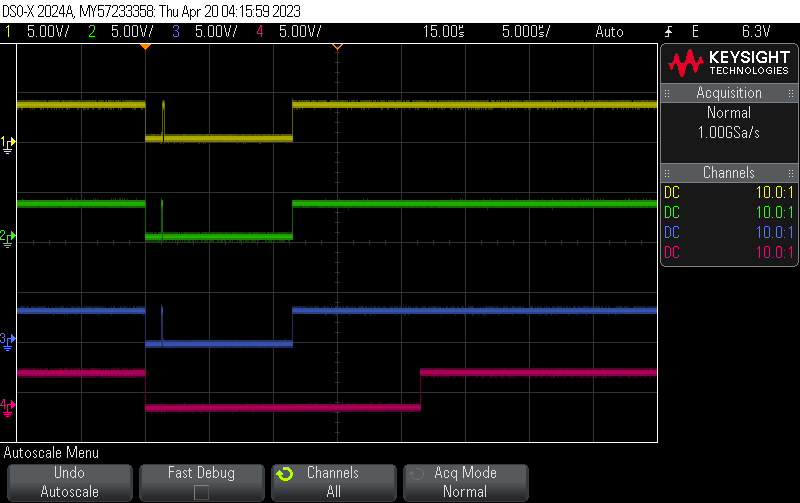

And definitely thank you for letting me know about the BSRR register. With respect to nops being bad for timing, I'd love to use timers with output compares for driving all of my I/O, but in my actual application (not my simplified one for this post) I need to drive 12 I/O in six states. The time between these states can be very short (minimum 5 nops @ 216MHz). I'd like to strive to only use timers but I'm not sure it's possible in this case.
2023-04-18 2:17 PM
Sounds difficult indeed, but it would be an interesting challenge, would you be so inclined to draw a timing diagram... :) No pressure, it may be lost time too.

I'd be happy to provide a diagram and appreciate any help! Maybe I could start with a scope shot that only shows 4 I/O but does show all six of the states? State one drives all I/O low for 10us, state two is variable width and drives some of the I/O high for a brief period (as low as ~20ns but typically ~80ns), state three is similar to state three but a different set of pins, state four has all pins low again, state five has all pins high except 4, and then state six has all pins high. If this is insufficient I could draw all 12 I/O in a diagram but this is obviously difficult to record with a scope. Also, I did notice I forgot to mention a 13th I/O which is the trigger for the scope.
