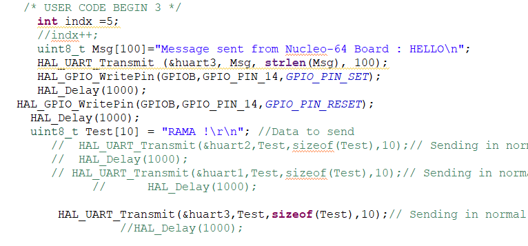

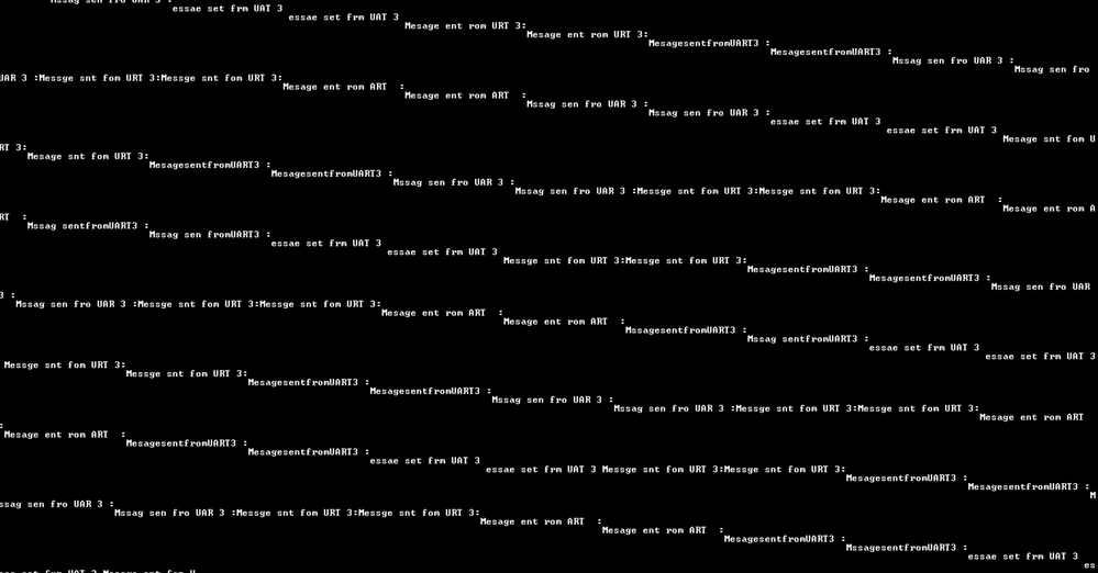

i can not get full text msg ,some alphabats are missing each time .how i can solve this ?

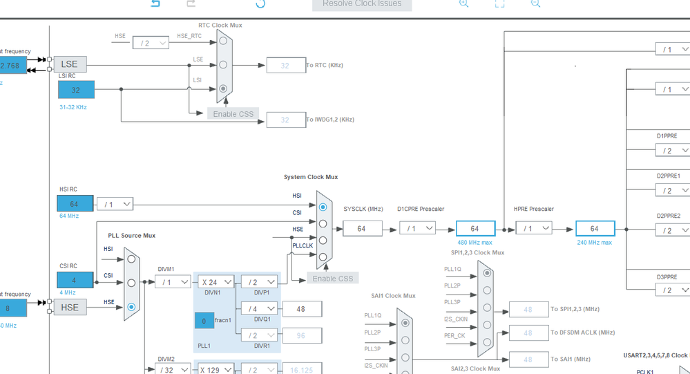

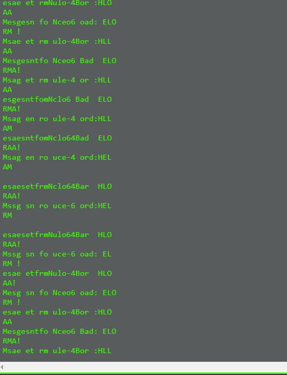

2023-04-19 9:26 PM - edited 2023-11-20 7:51 AM

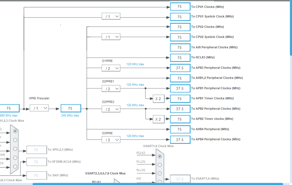

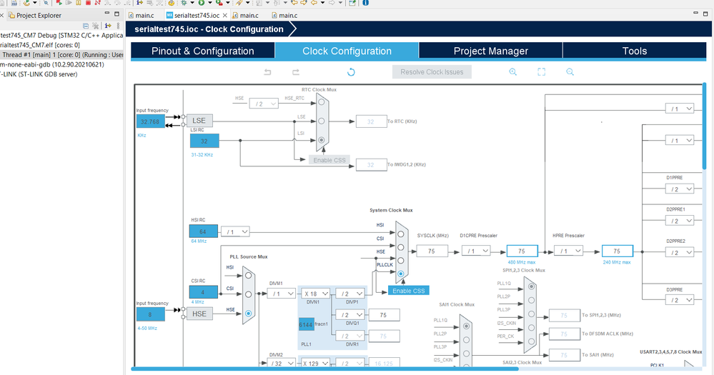

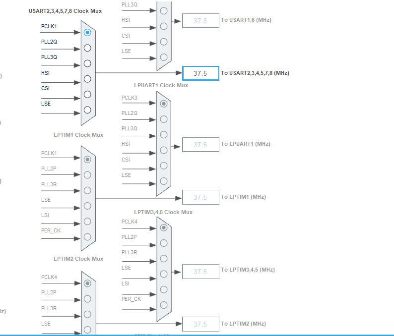

these are the clock setttinfg .but am doing wrong in clock side?these are the output in which alphabats are missing

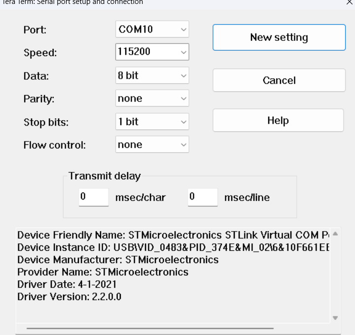

these are tera term settings

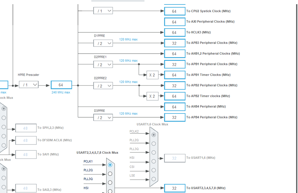

If this board is using an ST-LINK/V3 watch that HSE BYPASS is likely 8.333 MHz not 8.0 MHz
2023-04-19 9:59 PM - edited 2023-11-20 7:51 AM
this is the solution ,my code is working with this parameters
2023-04-19 10:00 PM
thank you ,my code is working ,setting are mention below
