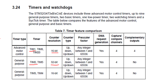

Hi as i want to use hall sensor interface to my input pwm capture
We can see these timers associated with digital hall,
Which one i can choose TIM1/8/20 or TIM2/3/4/5 also suggest on 16 bit and 32 bit timer preference.
Also can it be preferable to use advance timer for hall

Hello @sag
The choice between an advanced or general-purpose timer is directly based on the specific requirements of your application because both (TIM1, TIM8, TIM20) and (TIM2, TIM3, TIM4, TIM5) are capable of interfacing with digital hall effect sensors
So, if your application requires high resolution or a wide counting range for example, a 32-bit timer like TIM2 or TIM5 would be preferable because of its larger count capacity
If you need more features such as complementary outputs with dead time generation and break inputs, you should be using advanced timers (TIM1, TIM8, TIM20).

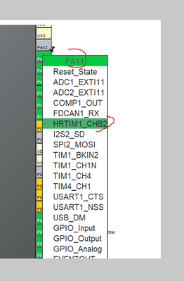

Also if i want to use PWM out for my motor driver inverter complement of each other.
Can i configure , HRTIM1_CHB1 for High & HRTIM1_CHB2 will be its complement Low.
For motor driver as i need total 6 pwm channels.
So in short HRTIM1_CHB1 for High & HRTIM1_CHB2 are complement of each other
Also rest of the timers like HRTIM1_CHA1, HRTIM1_CHA2,
As these i am considering for my motor driver 3 phase bridge
Please advice

Need pin details for the same which are opposite to the ref pwm

Can you please check on this PWM pins

ST_Sophia
Hello @sag
HRTIM main advantage is its high resolution, but it includes also a plenty of features. It is mainly used for Digital power application requiring a high resolution to regulate the PWMs very accurately and avoid transient perturbation when line or load change abruptly.
You can indeed use it for your application, considering 3 Timer Units (from Hrtim) and complementary behavior for the 2 outputs of each Timer unit.
Complementary behavior is enabled in CubeMx when deadtime option is selected, so you can configure SET/RESET for one PWM, and the other output in the same Timer Unit will follow with opposite polarity (and configured deadtime).
Please don't hesitate to request for additional information regarding the Hrtim configuration.
