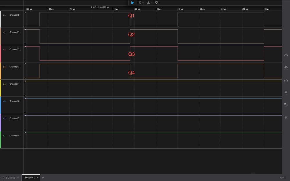

Drivinng ann H bridge to generate a sinewave , PWM generated and driving the H bridge .The PWM siganl as follows

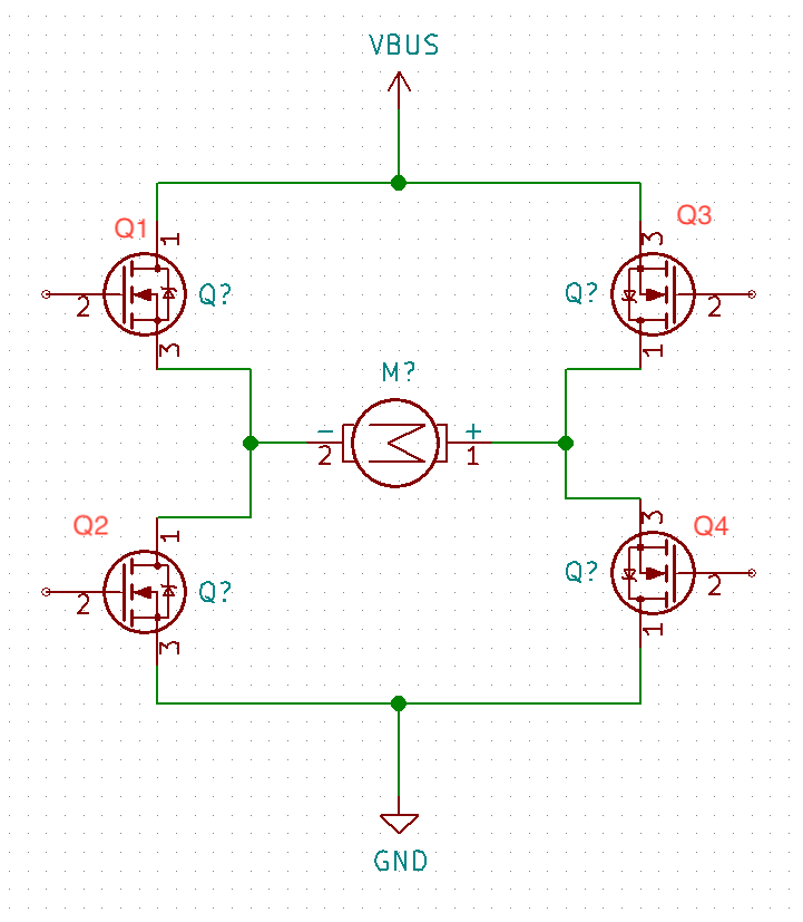

The H bridge Connection as shown below.
While appling supply the Low side MOSFET Q2 is Heating up Why so ?
I added some dead time also nothing happen .
I interchanged the H bridge  PWM signal as functioning as Q2 siganl is properly changed to Q4 ,Now the Q4 is heating .

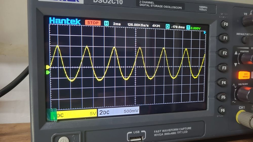

Also get a half sinewave shape little like a sharp peak like a triangle waves .
see the sinewave  below
