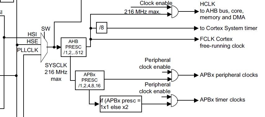

Print stuff out so you know what the system thinks it's doing, no need to be guessing..
printf("Core=%d, %d MHz\n", SystemCoreClock, SystemCoreClock / 1000000);
printf("HCLK=%d\n", HAL_RCC_GetHCLKFreq());
printf("APB1=%d\n", HAL_RCC_GetPCLK1Freq());
printf("APB2=%d\n", HAL_RCC_GetPCLK2Freq());
If you have APB as DIV4 and AHB as DIV4, the APB Clock will be DIV16 won't it? And the TIMCLK as DIV8
The diagram is inelegant, I'll give you that..

2018-12-18 2:15 PM
My mistake, had a problem with the clocks, my AHB prescaler was set to 4 but so was the APB prescaler, giving me 10 MHz, therefore 20 MHz for the clocks, now it makes sense. Thanks!
