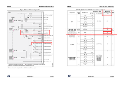

2025-12-15 7:05 AM - edited 2025-12-15 7:06 AM
Well, I guess the culprit here is the timer's kernel clock not being equal to its APB clock... a variant of this classic problem, but on steroids, as the 'N6 clocks' complexity went through the roof.
The definitive way to find out the truth is, as always, in reading out and checking content of relevant registers, here, in RCC.

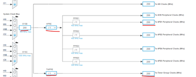

2025-12-17 9:00 PM
Hey @waclawek.jan, thanks for the reply.
I've read through what you've said, but I'm still unsure of how to configure my clocks within STM32CubeMX.
I have tried several different configurations, but cannot seem to get any to work without any modification in code.
I have been getting around this by doubling uwTimclock in code within HAL_InitTick();.
uwTimclock = HAL_RCC_GetPCLK1Freq() * 2;I haven't encountered too many issues caused by this in code, other than some inaccuracies in timing (FPS calculations, etc.).

2025-12-17 11:47 PM - edited 2025-12-17 11:48 PM
I don't use the 'N6 and I don't use CubeMX, but reading out the relevant registers' content is the ultimate way to determine, what's going on.
uwTimclock = HAL_RCC_GetPCLK1Freq();
I don't use Cube/HAL, but I am quite sure there will be some dedicated function to return the Timers' kernel clock (which as I've explained above may be different from the APB/PCLK1 clock). They should be timer-related examples in Cube, so try to find there; or, ultimately, as Cube is open source, you can simply have a look at the soruces to try to find the appropriate function yourself.
Or maybe somebody who uses Cube/HAL chimes in with a ready-made solution.
