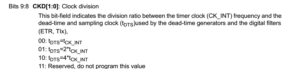

hi,
It works as expected!
''Clock division'' has nothing to do the clock prescaler.(okay, terminology is quite confusing!)
The CKD(clock division) bits and PSC bits(prescaler bits) have different meanings,
The former is about dead time and filter settings, it has nothing to do with prescaling as the name suggests.
Check the datasheet!
Zt

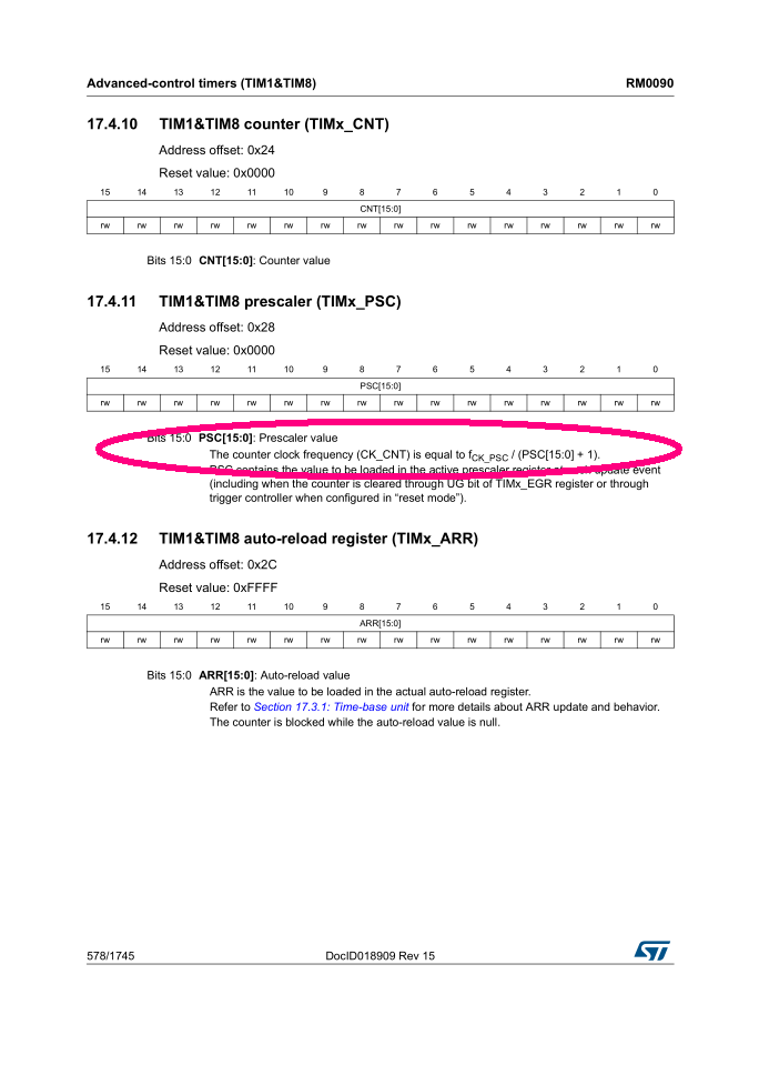

2017-06-29 3:13 AM
by the way,
your prescaler should be 16000-1

2018-03-04 7:02 AM
Thanks! I was also confused!
But the prescaler value of 16000 is right, it is the clock divider, so 16000000/16000 = 1 KHz freq = 1 ms.The Period should be XX - 1, like 1000 - 1 = 999 for 1 sec.
Cheers
2018-03-04 9:23 AM
Both Prescaler and Period values are expressed as N-1
Update Rate = TIMCLK / (P * Q)
Where
TIM4_Handler.Init.Prescaler = Q - 1;
TIM4_Handler.Init.Period = P - 1;
2018-03-04 9:33 AM
No.
