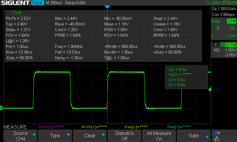

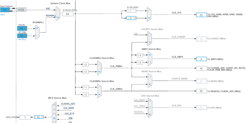

My clock tree initially looked like following image, checking the MCO pin with an oscilloscope tells me that indeed the HSE signal looked proper. (1MHz as expected after the 32x division on the pin itself).
Using the exact same settings, but changing the RC64MPLL from using HSI RC to PLL64M input, fails with the following error:

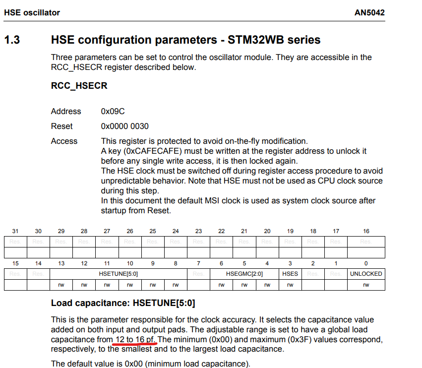

I found in one of the application notes for the STM32WB series (AN5042) that the tunning capacitors can only be modulated between 12pF and 16pF, perhaps my problem is to have external capacitors in the chip, thinking that setting the HSE tunning capacitors to 0 meant "0pF" of load added. I see the STEVAL-IDB013V1 schematic does not have external capacitors.
This application note doesn't seem to be linked on neither the BlueNRG-LPS nor the STM32WB05 ST Pages, and could not find it between it's linked documents. Could you help me confirm if this applies to the STM32WB05TZ chip?
