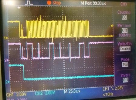

2014-07-20 2:48 PM
UPDATE:
I've changed the DMA request source from DMA2_Stream3 to DMA2_Stream5, which should be reserved for the TIM1_UP event. Interestingly enough, I see one stream of data probing the CLK and MOSI lines with my DSO as I start the application, but then it's over. Also no activity on the NSS line, which is strange. Thanks for your input!2014-07-20 4:17 PM

Also I attached a picture from the DSO (it should stream 32, 16-bit numbers periodically):
yellow - CLK, purple - MOSI, blue - NSS
