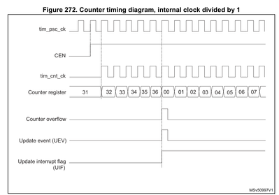

When a timer is in normal upcounting free-run mode, CNT resets to 0 after it reaches ARR. It does not need reset to 0, and in fact is already at 0 when the update event is handled.

It probably is happening. The timer is a hardware state machine, if UIF gets set, an update event occurred, and CNT got set back to 0. It may tick a few times before you can handle it, depending on the timer tick speed. Probably you should recheck your assumptions which led you to believe it's not being set. Why do you think it's not happening?

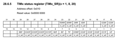

2025-02-18 6:09 AM - edited 2025-02-18 6:10 AM
Note that UE is not a flag within TIMx->SR, but UIF is. Probably that is what you want.
Using standard CMSIS defines can help avoid typos like this, even if in this case the typo didn't matter.
