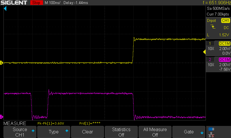

So the problem was that TIM_CCER_CC1NE needed to be set but that does something weird. 2uS before the inverted single pulse comes out there's a 175nS downward pulse. I'm about ready to tell them to put a 2n2222 on it and get their inverted output that way. Sometimes the path of least resistance is a little transistor.

Crystal cube hazy here, but I'm gonna guess it's the two enable bits being set in two separate steps, 175ns apart. Or something like that.
2020-03-06 3:56 PM
That's a good thought and I was in fact enabling the complementary output *after* the ordinary output. So for grins I reordered it and made sure I was only enabling it once. The first time It concides with the normal signal but then 2uS into the pulse it decides it wants to invert for 175nS. Subsequent output compare events trigger the positive channel normally but still the complementary channel has this weird pulse "from the future." Check it out. I'm bailing and will specify a 2n2222 or 2n3904 or something unless someone recognizes an easy fix because my volumes are small enough to support a three penny transistor and resistor.
