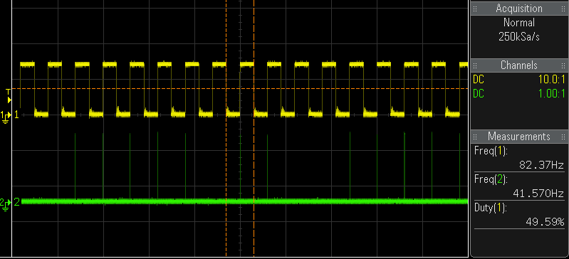

So, I fire output PIN on every interrupt for debug purpose with oscilloscope.

}But the picture I get looks like this:Looks like at random interruptions are not fired.

Are you sure it's not your oscilloscope which simply misses some of the pulses, as it's running at 250ksamples/s?

Also, now I see, that interrupts are not skipped, that was oscilloscope skipping impulse XD.
