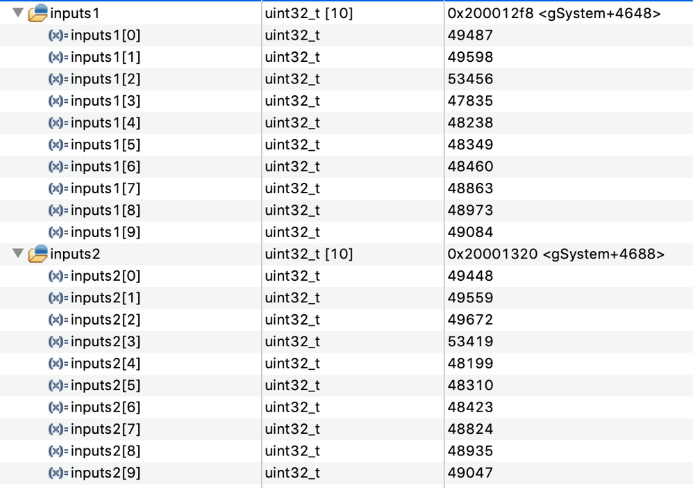

> On both channels? How do you know?
Yes on both channels. The interrupt handler is called. I'm then getting the capture values from CCR1 and CCR2. Some samples over time, captured in two ring buffers, for input channel 1 and channel 2 respectively:
The relative values between channel 2 and channel 1 look correct, but as you can see, the timer count keeps increasing rather than resetting like I'm expecting due to the slave reset.

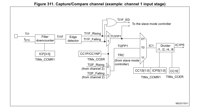

For TIM channel inputs I often refer to this picture:
You also may want to consider the delay between the input signal and the actual reset of counter. For IR decoding this probably does not make much difference, but you may want to bee aware of it. See final posts of https://community.st.com/s/question/0D53W000003zGZBSA2/stm32f0-input-capture-interrupt-quirk.
