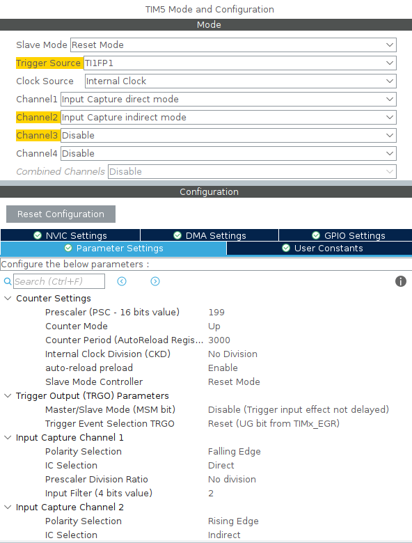

timer can capture full hi/lo pulse , just see my IR-receiver input:
i choose the timer5 clk+ prescaler, to get 1us tics; so on timer5 INT i get us count for hi and lo time of every incoming pulse.
perfect... right?
