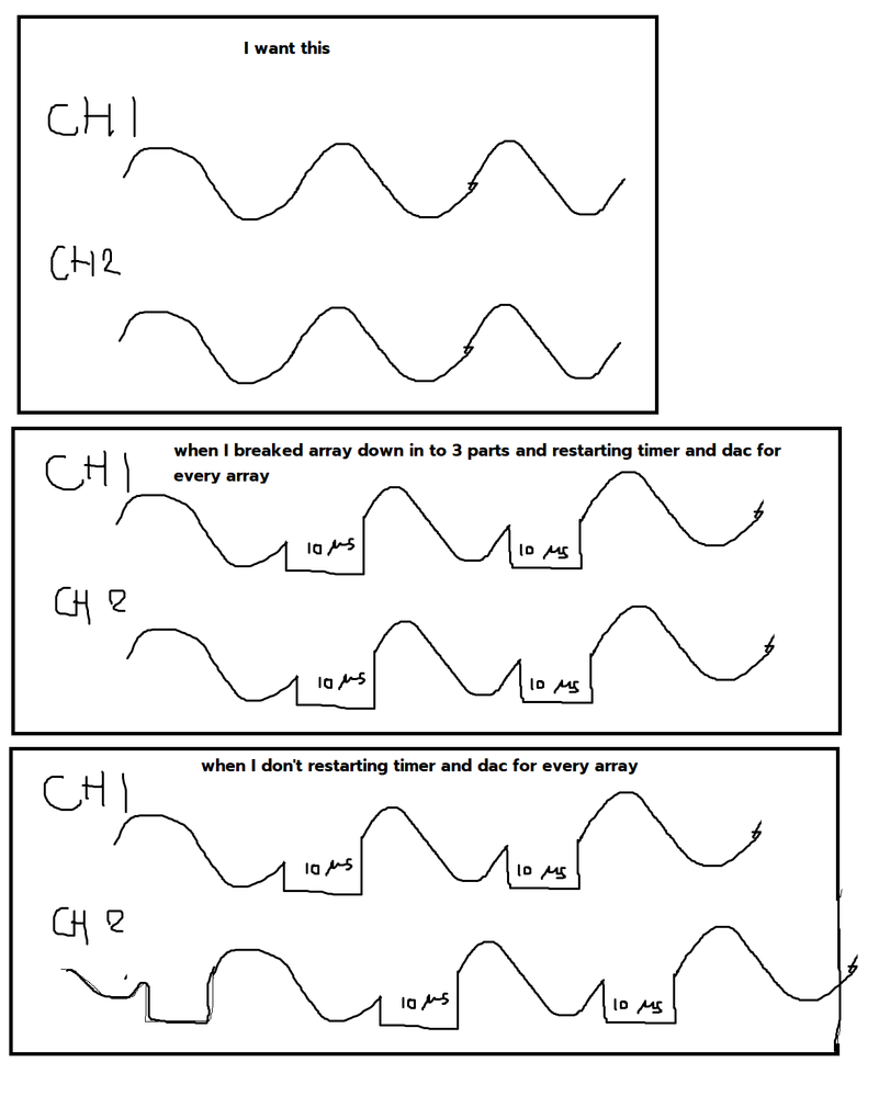

I actually want to transfer 2 arrays with 150,000 elements each in each DAC channel, but it is limited by the DMA size of 65535.
So, I have divided that array into 6 parts for example I_dac1, I_dac2 and I_dac3 and Q_dac1, Q_dac2, Q_dac3. I transmit both I_dac1 and Q_dac1 simultaneously to let it end at the same time.

Then there is a ~10 us time gap between each of my count which is not acceptable in my application. The 10 us time gap mostly come from disabling both TIM and DAC but when I tried not to disable it, the signal in both channels doesn't come at the same time which is not acceptable as well.
How do I do?
