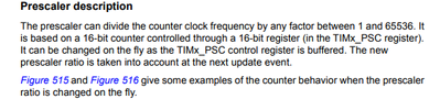

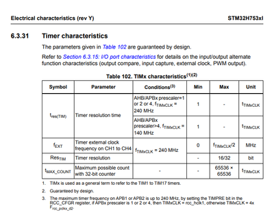

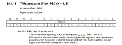

Please follow this wiki page to help you on TIimer Configuration and calculate the values: Getting started with TIM - stm32mcu
You can also check the description of timer in the Reference Manual RM0433
