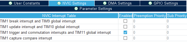

After being happy with the PWM timer, I enabled the commutation interrupt
TIM1 InterruptsTIM1 Interrupts
In the beginning I also had the update interrupt and that was working and firing. Then in my loop I was simply trying to fire a commutation generation event about once every second (just rough test). The if statement runs but the "void TIM1_TRG_COM_TIM11_IRQHandler(void)" routine never runs for some reason.

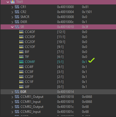

In your timer screenshots, TIMx_DIER=0x1, i.e. only UIE is set, not the commutation interrupt enable bit.

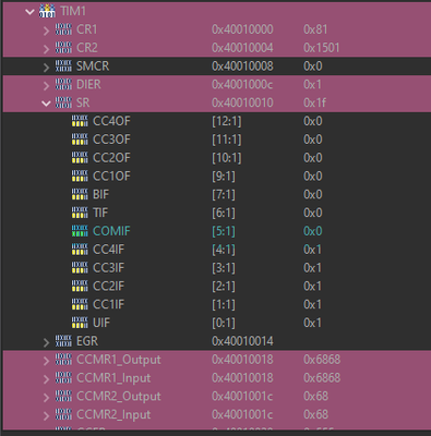

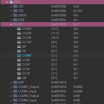

I've also checked the TIM1->SR and the COMIF bits, before and after event generation.
Before Event GenerationBefore Event Generation
After Event GenerationAfter Event Generation
After The Clear FlagAfter The Clear Flag
Satisfied that the COM interrupt flag is set and I can manually clear it I changed the main loop back to

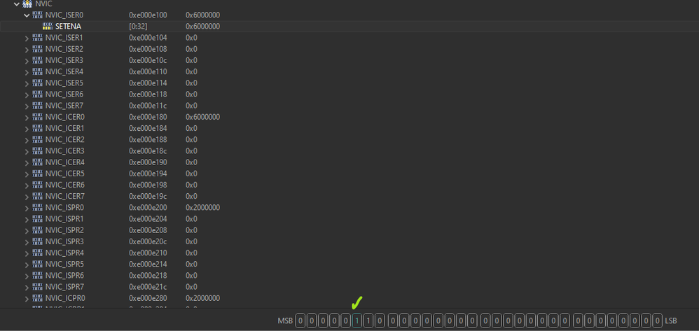

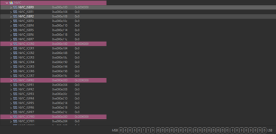

I'd like to add the contents of the NVIC registers, I've been trying to read through RM0090 to find the ISRx registers but have not been able to locate that. Thus I have a hard time knowing whether the interrupt enable lines are actually configuring things correctly. I attach here a picture of the registers, If anyone knows what page in RM0090 it is or in some other document I'd appreciate that.
NVIC ISERxNVIC ISERx

I've looked even deeper into it, turns out this IRQn is 26, defined in IRQn_Type enum.
  TIM1_TRG_COM_TIM11_IRQn     = 26,     /*!< TIM1 Trigger and Commutation Interrupt and TIM11 global interrupt */
The HAL_NVIC_EnableIRQ, calls NVIC_EnableIRQ with that number, which is a macro for
__STATIC_INLINE void __NVIC_EnableIRQ(IRQn_Type IRQn)
  if ((int32_t)(IRQn) >= 0)
    __COMPILER_BARRIER();
    NVIC->ISER[(((uint32_t)IRQn) >> 5UL)] = (uint32_t)(1UL << (((uint32_t)IRQn) & 0x1FUL));
Then here if I am not mistaking, we divide the number by 2^5 = 32, to find which ISERx register 32 bit words this number belongs to 26/32 = 0 so ISER0. Then we extract the lower 5 bits of 26 which is 26. And put one into bit 27 (if counting from bit 0).
That then corresponds to the following highlighted bit
ISER0 bit 27 setISER0 bit 27 set
I don't know how to see if there is some mismatch in the NVIC controller or something for why this is not firing. I hope I have provided enough information for anyone that would be able to help me :)
waclawek.jan
Super User
