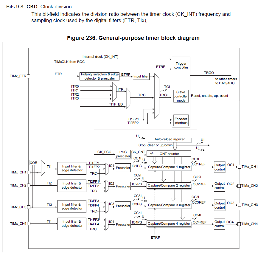

I re-read the documentation and it was written, so I should have paid more attention to this small detail.
Here is the extract from the user manual, It's clear that the clock division is link to the digital filter
