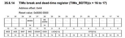

With HAL, use HAL_TIM_PWM_Start() to enable PWM output.
Without HAL, set CCER register and MOE bit in BDTR.
2024-01-11 12:57 AM
For advance timers only (TIM1, TIM8, TIM20), to get an output, you have to enable the main output of the timer which is the MOE bit
