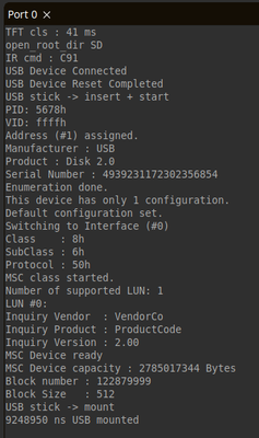

2024-03-19 8:02 AM - edited 2024-03-19 10:57 AM
ok, so via swd + DWT counter ->
about 9,2 ms from inserted to fatfs mounted ok;
is 64 GB (noname chinese..) USB stick, exfat , 50GB free.
btw
How often you call the MX_USB_HOST_Process(); ?
I call it in main loop about every some 5us ....nothing else to do now, waiting for first command.
So this might be maximum speed, that can be achieved .
ed

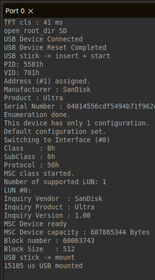

Just for fun - had the idea, to try an old SanDisk 32GB stick, fat32, also, got ->
about 15ms insert to mounted. Ok for this piece of plastic shi.t , i think.

2024-03-19 3:51 PM - edited 2024-03-19 3:53 PM
> about 9,2 ms
This is what should be.
Time individual MSC class requests to find where it wastes time. The capacity in bytes vs block numbers look suspicious.
