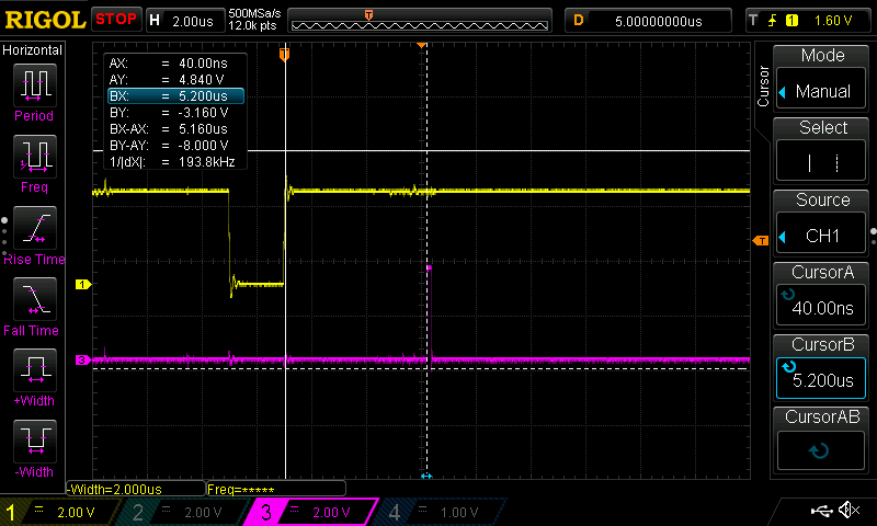

TIM_OC1Init(TIM4, &outputChannelInit);Scope trace looks as expected:

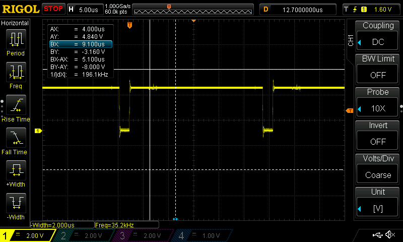

//TIM_ITConfig(TIM3, TIM_IT_Update | TIM_IT_CC1, ENABLE);TIM3 IRQ handler toggles a GPIO line (magenta trace) on TIM_IT_Update
Q1: Why is there a delay between TIM4 Update and Tim3 Update? I expect TIM3 being a slave would be very close to when TIM4 starts a new period - ie falling edge of hsync pulse.
Now I also enable the TIM3 CC1 IRQ as well as Update IRQ and get this:
You can see the CC1 IRQ gets generated a little before the Update IRQ (as expected)..but..
Q2: TIM3 CC1 has the same Pulse value as TIM4, but the IRQ is much later..I expected TIM3 to be pretty much in phase with TIM4
2021-02-20 7:53 AM
[Answering my own question for anyone reading this later that find its useful]
I noticed that slave pulses were always around 30 CPU cycles later than master. Looked at the code I spotted that TIM3 was ENABLEd about 20 odd instructions before TIM4 was ENABLEd.
Enable them both at the same time and its perfect.

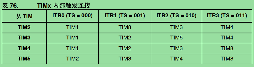

Keep getting caught out by the non-orthogonal functionality on these devices!
In this case, TIM4 triggers TIM3 not on ITR0 but only on ITR3. Found this handy map on a website (subsequently found it on p401 of RM0008)
