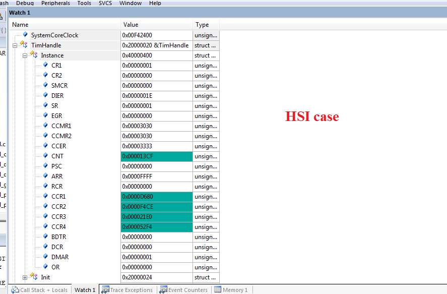

Read out and check/post the content of TIM3 registers.
2018-04-17 7:44 AM
Thanks for the reply . here is a screenshots of register details .
2018-04-17 9:23 AM
There are multiple problems: ARR is 0xFFFF i.e. timer period is maximum possible; pulses lengths is also not what you described, and the output compare mode is Toggle not PWM.

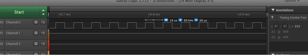

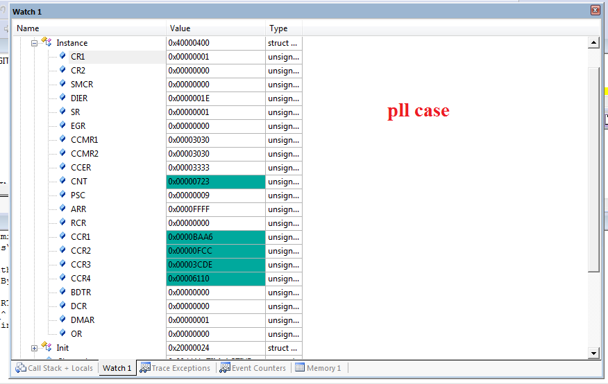

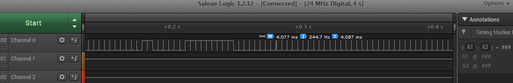

2018-04-18 12:31 PM
yes , ARR
Is highest value possible , but the timer is configured to toggle the channel when it meets with CCR1 . and CCR1 is updated as below .
* @brief Output Compare callback in non blocking mode * @param htim : TIM OC handle * @retval None */void HAL_TIM_OC_DelayElapsedCallback(TIM_HandleTypeDef *htim){ /* TIM3_CH1 toggling with frequency = 195 Hz */ if(htim->Channel == HAL_TIM_ACTIVE_CHANNEL_1) { uhCapture = HAL_TIM_ReadCapturedValue(htim, TIM_CHANNEL_1); /* Set the Capture Compare Register value */ __HAL_TIM_SET_COMPARE(&TimHandle, TIM_CHANNEL_1, (uhCapture + uhCCR1_Val)); } }it is indeed working with PLL . you can see the output below pll vs HSI
