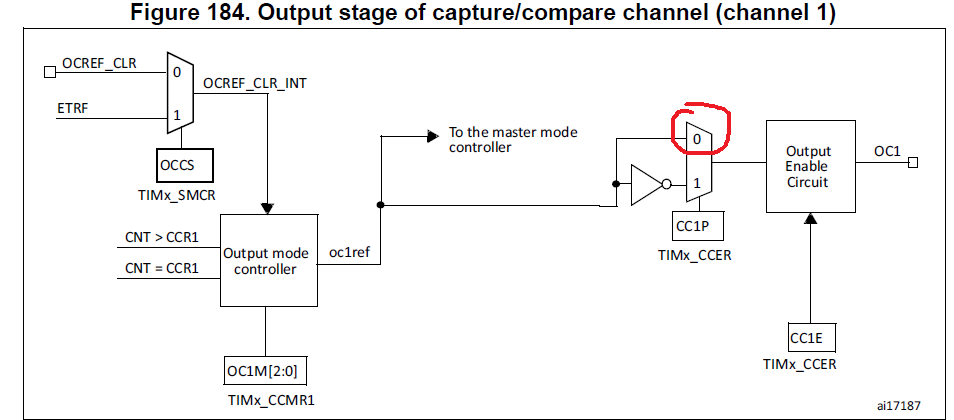

I have been experimenting with OC mode of the TIMER2 and couldnt able understand the terms
OCPolarity and Active and inactive mode.

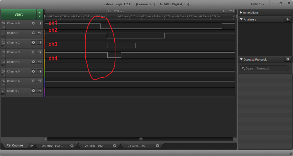

below trace i got from this configuration
/* Common configuration for all channels */
sConfig.OCMode = TIM_OCMODE_ACTIVE; sConfig.OCPolarity = TIM_OCPOLARITY_HIGH;I was expecting OCMODE_ACTIVE means channel will be held HIGH , but on a match channel forced to low,
why is that ? can you please help me to understand this ?

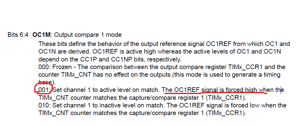

Hello dhenry , Thanks for the reply ,
I indeed gone through the RM to get details and compared with Register programmed values values .
since CC1P is 0, OCREF should come as non inverted.
