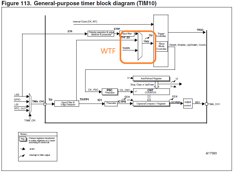

The block diagrams seems to suggest a level of functionality that the registers do not support. I can't see how to get this into ExternalMode1
2014-03-25 10:31 AM
WTF too!!
The TIM9 (Figure 140. TI2 external clock connection example) have TS bits that can configure this, but on TIM10 there are not these bits. (TIM9 can't work with LSI).2014-03-25 11:22 AM
I pushed into moderation for an explanation of the block diagram, because the multiplexor doesn't exist.
The LSI is not a crystal, it's a rough RC at 40 KHz The LSE should be able to clock the timer What are you trying to do with the LSI clock, can you do that with the RTC and changing the prescaler there?2014-04-07 1:59 AM
