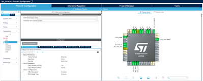

Hello, I currently have a test bench project to carry out, so it's a drive motor that turns another motor, which generates an FCEM signal on my 3 phases, but the duration of the signal depends on the speed at which I'm turning, so I'd like to use timer 1 on the STM32F103C8T6 to count the number of pulses between 2 rising edges, if you could help me. I'm using an rx tx link to have a master and a slave, the master at a frequency of 93.5 kHz on the cpu and I'd like to know if it's possible to count the number of pulses from my 3 phases at 72 MHz. If you could help me please thank you.
i changed spi to usuart
