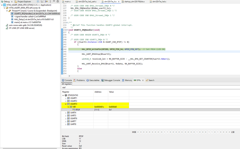

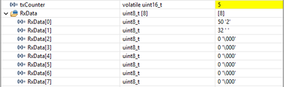

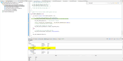

2026-01-05 7:10 AM
Hello @Brussl
For now, I suspect that there is a mistake in your configuration.
Check the RTOR register content.
You might be setting the RTO field to a value that is not reached.
I tried to replicate your issue on an STM32H745, as you did not specify the STM32H7 device you are using.
You can try this approach or use it as a reference. Porting it should not be difficult.
To test it, connect the PD8 pin to the PD9 pin to attach USART3 TX to USART3 RX.
When the RTOF bit is set, the PB14 pin (user LED3) is set.
Set a breakpoint at the following line of code to ensure you do not miss the RTOF bit being set:
HAL_GPIO_WritePin(GPIOB, GPIO_PIN_14, GPIO_PIN_SET);
You can visualize this using the SFR window.
The project is configured to transmit incrementing numbers every four seconds(you can see it using a serial monitor).
You can see that RX receives the number using the live expression buffer RXdata, and RTOF is 0.
After the RTO time elapses, user LED3 turns on, and the RTOF bit is set. This is especially visible if you set a breakpoint in the mentioned line in the USART3_IRQHandler function.
I attached the project in the reply
Hope this helps you find the solution, if yes please accept it so it becomes visible for other users
Gyessine

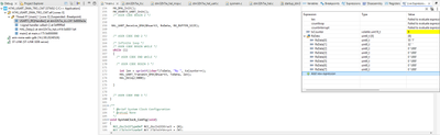

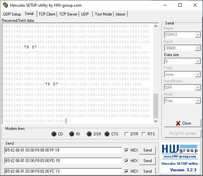

2026-01-08 8:00 AM
Hello , Gyessine. Do you sure about DMA save date in buffer? I have very strange situation. The counter of received bytes is real, but buffer is empty. I send on other UART length and write two bytes in DMA buffer to see how change it DMA, but is not changed.
uint8_t txt[20];
void USART2_IRQHandler(void)
/* USER CODE BEGIN USART2_IRQn 0 */
if ((huart2.Instance->ISR & USART_ISR_RTOF) != 0)
HAL_UART_DMAStop(&huart2);
__HAL_UART_CLEAR_FLAG(&huart2, UART_CLEAR_RTOF);
uint16_t received_len = DMA_BUFFER_SIZE - __HAL_DMA_GET_COUNTER(huart2.hdmarx);
//memcpy (&rx_buf, &rx_dma_buf, received_len );
uint16_t len = sprintf((char*)txt , "%u ", received_len );
HAL_UART_Transmit( &huart1, txt, len, HAL_MAX_DELAY);
HAL_UART_Transmit( &huart1, dma_buf ,DMA_BUFFER_SIZE , HAL_MAX_DELAY);
dma_buf[0]=0x35;
dma_buf[1]=0x37;
HAL_UART_Receive_DMA(&huart2, dma_buf, DMA_BUFFER_SIZE);
else
HAL_UART_Transmit( &huart1,"TE",3,HAL_MAX_DELAY);
/* USER CODE END USART2_IRQn 0 */
HAL_UART_IRQHandler(&huart2);
/* USER CODE BEGIN USART2_IRQn 1 */
/* USER CODE END USART2_IRQn 1 */
I check and memory increment is OK.
this is from serial monitor:
79 is real data length , 57 are bytes that can be changed if DMA write something in buffer.
