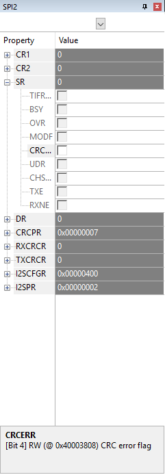

I changed the intitialization of i2s and set the PB15 as the sd line. But still it stuck on the function belows and gives the timeout error. This function is from "stm32f4xx_hal_i2s.c" file.

}As i understand, the i2s's SR register gives the error. But, i looked the register value via system analyzer and here is the values in image below. Actually there is only one active value.
Best regards.
2019-03-18 5:09 AM
I see that SPI_I2SCFGR.I2SMOD=0, which means SPI mode. That's definitively wrong.
