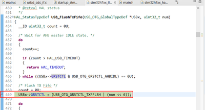

The local variables below when break stop on 469 line.

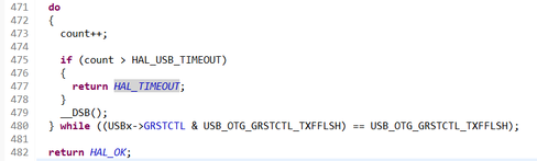

Hi @jimmy_cheng
I have seen a similar issue on F4, could you confirm inserting __DSB(); resolves the issue to ensure transaction is complete.
