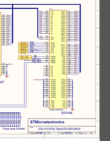

As Clive states, address 0xc000000 likely enables the CS pin of that SDRAM. Pin PH3 (MCU) is shown tied to that Ram CS - thus the relationship between 0xc000000 and PH3 (not intuitive to this reporter) must be discovered. Probing CS (via scope) of that Ram while generating address 0xc000000 will further illuminate.
Note that the 2 buffer addresses have a 2:1 ratio - suggests that one holds frame-buffer and the 2nd better enables ''collision-free'' fills of the frame - which may then be ''ping-ponged.'' Likely that the range of both Ram buffers are equal... Again - as Clive states - should you modify any demo ''defaults'' you must better understand how the Ram is mapped - and avoid over-writes of any/all critical sectors...We’re moving the ST Community to a new platform to give you a better and more reliable community experience.
