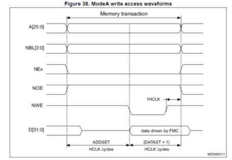

The external device expects EXTMODE ModeA timing like the following figure.
Reference from
RM0410 Rev 4 Reference manual
STM32F76xxx and STM32F77xxx advanced Arm®-based 32-bit MCUs
Our issue is that NEx signal and NWE signal are falling down at the same time on our target board.

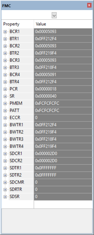

The relevant FMC registers' content is as following.
BCR4 = 0x00005091
BTR4 = 0x0FF212F4
BWTR4 = 0x0FF219F4
I attach the picture of the the all FMC register's content on MDK-ARM.
This picture took after initializing on our target board.
Thanks in advance for any help.
Thanks,
Hiromichi
2019-11-27 10:45 PM
This appears to be OK to me.
