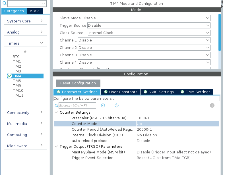

That's how it looks:
  • Started the TIM4 interrupt mode:
/* USER CODE BEGIN 2 */
  HAL_TIM_Base_Start_IT(&htim4);
  /* USER CODE END 2 */
  • The counter values should be incremented in the middle and in the end of the period, however it doesn't happen. There is a problem with the HAL_TIM_PeriodElapsedHalfCpltCallback function. The half_elapsed variable is not inctemented during debugging.
/* USER CODE BEGIN 4 */
void HAL_TIM_PeriodElapsedHalfCpltCallback(TIM_HandleTypeDef *htim)
	half_elapsed++;
void HAL_TIM_PeriodElapsedCallback(TIM_HandleTypeDef *htim)
	elapsed++;
/* USER CODE END 4 */

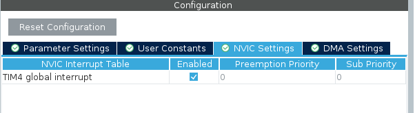

  • These are my Cube settings:
8 REPLIES 8
TDK
Super User
HAL_TIM_PeriodElapsedHalfCpltCallback is not called in most scenarios, including this one. It's used during certain DMA transfers and is called when the DMA's HT interrupt kicks off.
