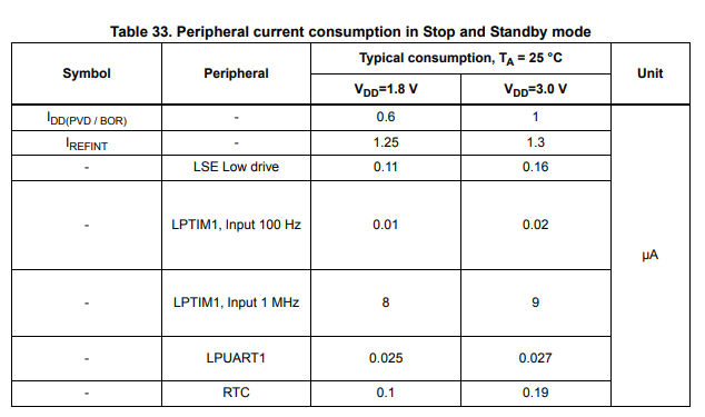

Hello @LaurentLef,
Please check the parameters mentioned in the DS11100 and precisely in table 33 (as shown below).
Thank you for your contribution in the ST community.
