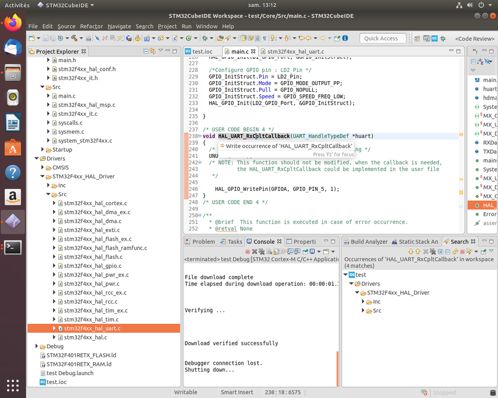

I know the issue now! The function is not declared yet. How can I declare that function so DMA knows that it exist?
/* USER CODE BEGIN 4 */
void HAL_UART_RxCpltCallback(UART_HandleTypeDef *huart)
/* Prevent unused argument(s) compilation warning */
UNUSED(huart);
/* NOTE: This function should not be modified, when the callback is needed,
the HAL_UART_RxCpltCallback could be implemented in the user file
HAL_GPIO_WritePin(GPIOA, GPIO_PIN_5, 1); // Nothing happens here
/* USER CODE END 4 */The function is avaiable in stm32f4xx_hal_uart.c file.

}But if I hover the mouse over the function it looks like this

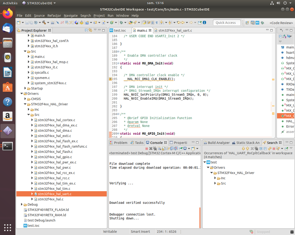

I'm also got some weird errors on DMA C-code. These errors says Missing ';'

2020-01-04 6:15 AM
But I'm using STMCubeIDE. That should be generated by itself. Or is it a bug?
2020-01-04 6:27 AM
2020-01-04 11:58 AM
Thank you! That solved my issue. I init the functions like this
