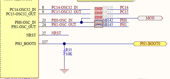

Ok, and what have you learned in the debugger, having stepped in from Reset_Handler ?
Check your design for BOOT0 pin/settings.
Check your HSE clock source is present and starts properly.

I run it in debugging.

Thank you. I solved it。BOOT0 pin must be set Low。I opened it。:face_with_tears_of_joy:
