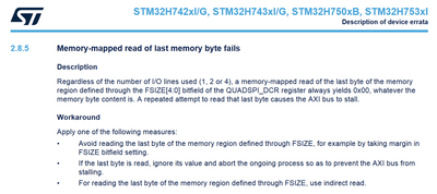

Also, the errata sheet ES0392 mentions the same problem.
Which is a better approach?
  1. FSize + 1
    • Allow overflow access to the flash when using STM32CubeProgrammer
  2. Do not change FSize
    • Do not write to the last 4 bytes
  1. FSize + 1
