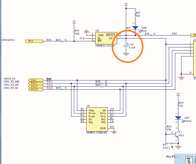

You can't use PA9 on the STM32F4-DISCO, it connects to a huge bulk capacitor related to the USB interface. Review the manual and schematic. RealTerm needs to see a serial port, just plugging the board into a USB port does NOT achieve this. What you need to do is connect the USART TX/RX pins to a USB-to-CMOS Serial type converter board/cable. I'd recommend using USART6 and PC6,PC7.http://www.dlpdesign.com/usb/txrx.shtml

You can't use PA9on the STM32F4-DISCO, it connects to a huge bulk capacitor related to the USB interface. Review the manual and schematic. I don't understand why? Cause when I checked the manual of stm32f407 and stm32f4Discovery I didn't find what you're talking about, I found that PA9 is connected toUSART1_TX/TIM1_CH2/I2C3_SMBA/DCMI_D0/OTG_FS_VBUS and PC6 is connected toI2S2_MCK/TIM8_CH1/DIO_D6/USART6_TX/DCMI_D0/TIM3_CH1 so both of them is connected to many possible Alternate functions, so what is the point? would you explain? and what is the difference between the manual and the schematic? 5- RealTerm needs to see a serial port, just plugging the board into a USB port does NOT achieve this. What you need to do is connect the USART TX/RX pins to a USB-to-CMOS Serial type converter board/cable. so there is no other way to check if USART is working without this USB-To-CMOS cable? and If you connected this cable to USART Tx/Rx, will the realterm display the output automatically? Thanks a ton for your patient and kindness

It includes stm32f4xx.h, the code itself doesn't need anything in the discovery file, but if you want to go beyond the basic demo, and say control LEDs or buttons, or port something from the other EVAL boards this is the point of abstraction. ie you mix-and-match code between the discovery specific firmware library, and the F4 DSP library which targets the EVAL series boards. The stm32f4xx.h in turn loads your localized stm32f4xx_conf.h, which should contain board specific details. The most problematic thing to remember is that the Discovery boards use an 8 MHz HSE crystal, whereas the EVAL boards typically have 25 MHz crystals to support Ethernet options. The assert infrastructure is optional, but code throughout the library does parameter checking, this can be useful for ''Debug'' builds which while slower can do sanity checking, and catch logic/functional errors in your surrounding code. You do have to either do it, or not do it, so if some portions of the code think they should do it, and you fail to provide the support code, you get these linker errors.2014-03-22 10:01 PM
Pins have multiple functions, it is a puzzle to get all the peripherals you want out of the chip. It's generally impossible to get all the peripherals in the chip to function together, and out side. You can get higher pin count devices, which makes life easier, but you're still be able to use a sub-set of the functionality. The design of the STM32F4-DISCO further limits you by applying specific functions, and connections to the chip. With your own design you have more flexibility, but it is still a task to ''fit'' the functionality. ST has an Micro Xplorer tool (and CubeMX), that can here work through the pin assignment.
