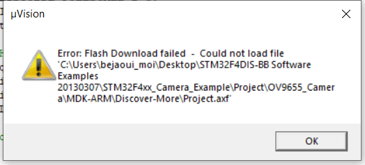

i build the code of "STM32F4DIS-BB Software Examples 20130307: STM32F4xx_Camera_Example" but it can't create the .axf file.
who had an idea?
Thanks.

Yep. The free Keil license allows up to 32KB.
Try to reduce the size a little (enable size optimization, remove some unused code/data)

The build has a FATAL, try looking at that as nothing downstream is going to work. You can't debug things that don't build.

.\Discover-More\Project.axf: error: L6050U: The code size of this image (33952 bytes) exceeds the maximum allowed for this version of the linker.
