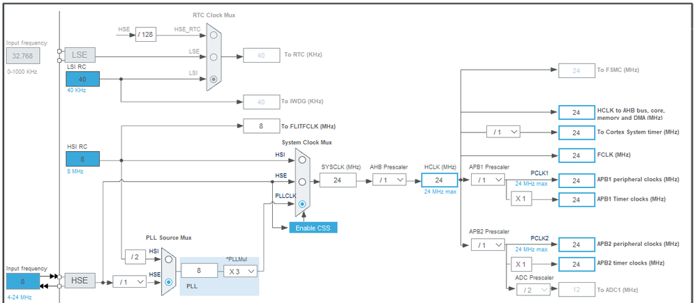

To be sure, I tried creating a new project with the latest version of the ST library to verify the problem doesn’t come from my old versions of files. I used STMCubeMX and created a new empty project for the STM32F100VE with the same clock configuration but no changes, it also doesn’t works. I have the same observations CFGR2/PREDIV1 bits or PLLXTPRE bit are not written.

Besides to what was already asked/suggested by @STOne-32 , could you please try this configuration: "PREDIV1 = /1" and "PLLMUL = x3" with HSE as input clock in order to reach the 24 MHz? Does it work for the 3 references as expected?
