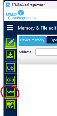

Please try using the CubeProgrammer (GUI or CLI), it has SWO output mode.

Pavel A's suggestion of using the Serial Wire Viewer in the STM32CubeProgrammer do work(!) and I can see both the characters nad the printf data numbe increase. Very strange, but it seems the STM32Cube has some errors regarding SWO output.
