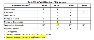

2024-03-21 2:10 AM
Hello @JoachimO,
To be precise LPTIM2 is functional only in stop1 mode. As shown in the figure from AN5645
This is inline with the description in the RM:
Sorry for the confusion!

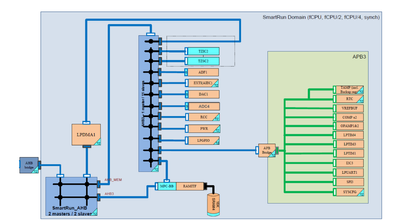

Hello @JoachimO, welcome to ST Community
>>s it even possible? LPTIM2 is connected to a different bus than the other LPTIMs.
Indeed, in SRD, only LPTIM1, 3, and 4 are available:
You can check the table of all the autonomous peripherals supported in stop2 mode in Getting started with LPBAM

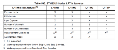

2024-03-19 11:27 PM
Is there an error in the reference manual (RM0456, page 2465) or how is the line "Autonomous mode" to be understood?
2024-03-21 2:10 AM
Hello @JoachimO,

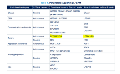

2024-03-21 2:23 AM
In the first table of your post, LPTIM1/2/4 are named for autonomous mode in Stop 2 mode.
Shouldn't that be LPTIM 1/3/4?
In the second table at LPTIM4 there is no autonomous mode available?
In relation to the table above, this would be a different statement.
2024-03-21 2:36 AM
Thank you @JoachimO
>>Shouldn't that be LPTIM 1/3/4? Indeed!
This typo should be corrected (Issue reported internally: Ticket 176652)
