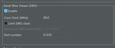

You'll have to configure the SWV viewer clock rate to match your system clock. In STM32CubeIDE, this is done in the debug configuration window.

I am using OpenOCD. I found that the SWO clock frequency was not set correctly, but I don't understand why.
Anyways, with a core clock frequency of 25MHz and a SWO clock frequency of 2.25MHz I am able to view SWO output
