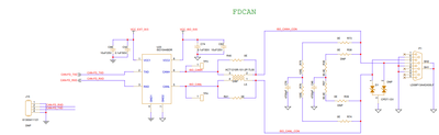

It's a bad idea to share the same pins between UART and FDCAN. Externally, the HW is not the same: CAN transceiver + a RS232 driver or STlink virtual comport.
So need to separate the pins.

You share USART4 and FDCAN1 pins, this supposes that FDCAN1 is seeing USART HW on its pins where you are switching to it! which is not recommended. You need to have free pins for FDCAN.
Which board are you using? Could you please share your schematics?

As stated before it's a bad idea to share the pins even one peripheral is used at a time. The FDCAN transceiver will disturb UART and seemingly UART HW (RS232 driver, STLINK VCOM or whatever attached) will disturb the FDCAN communication.
So need to separate the pins and dedicate pins for each interface or use a MUX on these pins.

It's a little bit sad that nobody explains why this is not working...
The probable cause is a problem not related to the STM32:
When connecting 2 low impedance / push-pull outputs, one output "shorts" the other one.
This might only work with open-drain / open-collector outputs.

Moreover, even in the inverse case (no output shorts), there will be an issue with CAN_Tx & UART_Rx / CAN_Rx & UART_Tx sharing the same pins because the external transceiver/driver will force its output at a level that will disturb the current peripheral not using the driver/transceiver.
Conclusion: in both cases it's a bad idea to share the pins as stated above. So need to MUX them by an external HW.
