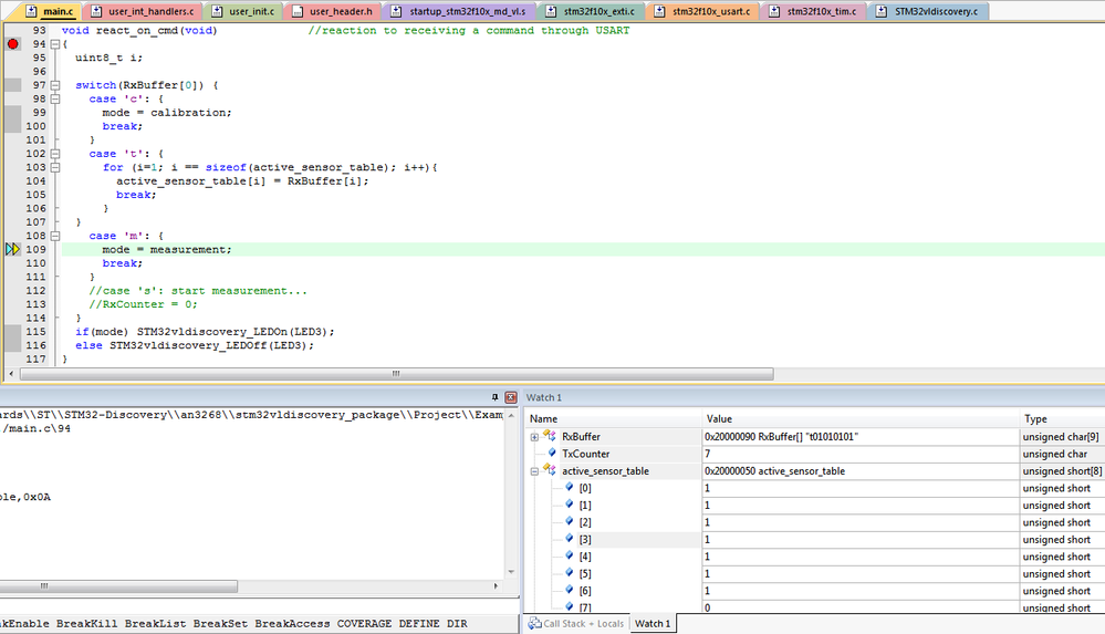

I just can't understand this... So, I'm communicating with PC's terminal program via USART2 on my STM32F10. Communication is running smoothly both ways, but I have a problem when I want my embedded system to respond appropriately to PC's commands. Basically, when ''I'' receive 9 characters, I read the first character and optionally what's behind, but mostly just 1st character matters. So, if I send for example 9 x m (RxBuffer = ''mmmmmmmmm'') or any combination of 'm' and ''whatever follows'', it seems to work fine, and the LED goes off. Similarly with 'c' (LED goes ON). But, if I send i.e. ''t01100100'' or ''ttttttttt'', switch interprets it as 'm'. o_O Well, screenshot says it all. Thanks for taking time :)2014-05-15 9:18 AM

Post the code, I can't edit text in graphical format....

void react_on_cmd(void) //reaction to receiving a command through USART
{ uint8_t i; switch(RxBuffer[0]) { case 'c': { mode = calibration; break; } case 't': { for (i = 1; i == sizeof(active_sensor_table); i++){ active_sensor_table[i] = RxBuffer[i]; } break; } case 'm': { mode = measurement; break; } //case 's': start measurement... //RxCounter = 0; default: { strcpy(TxBuffer, ''\nCommunication error''); //send RST indicator to PC TxCounter = 0; USART_ITConfig(USART2 , USART_IT_TXE , ENABLE); } } if(mode) STM32vldiscovery_LEDOn(LED3); else STM32vldiscovery_LEDOff(LED3); } Is this sufficient or you need other parts of program?2014-05-16 1:37 AM

One thing first, don't put braces around case statements, i.e.switch(expression){ case 1: ... break; case 2: ... break; default: ... break;}Second thing, in case't', the for loop will never execute, unless active_sensor_table has only one element. It should be defined as(for i = 1; i < sizeof(active_sensor_table); i++){...}Then if your table contains words, since sizeof(active_sensor_table) will give you the size in bytes, you'll have a runaway pointer for sure...Have a nice day2014-05-16 2:59 AM
Wau, thanks, i think those brackets were the issue (gotta relearn the syntax i guess :))! I also repaired the sizeof() - countof = (sizeof (a)/sizeof(*a)).
